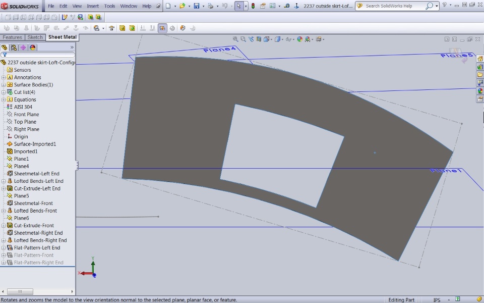

Is there a way to use the output alignment to output the dxf in a certain orientation other than the default.
Here is my flat pattern that I would like to output in a more horizontal orientation.
I was hoping I could use the bounding box to indicate X and Y axis and part origin, but that doesn't seem to be an option when selecting. I can set the origin as the corner point of the bounding box, but i can't select the X and Y axis.
