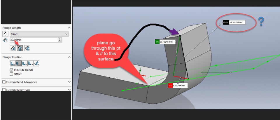

30 mm is the length of an Inner Virtual Sharp. One point should be at surface of the Edge Flange, where should be the other end? Is it a random end at 30 mm away from Edge Flange surface?
Planes // to Edge Flange surface and going through Base Flange corners were tried but did not show any correct result.
