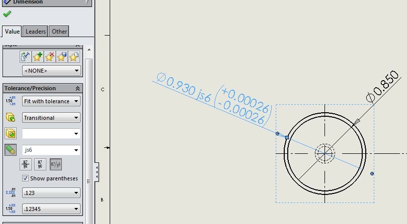

I don't know what to do.  I am trying to callout a fit in a drawing but when I place the fit it looks like this.....
This is the correct callout "js6" how ever if you look in the machinist hand book....
the second column does with the clearance and interference #'s shows that it is not a symmetrical #.  The only way I can get Solidworks manually change them is to take it off the shaft callout and not have anything selected.  Is this correct way for solving this problem?  Thanks in advance.
