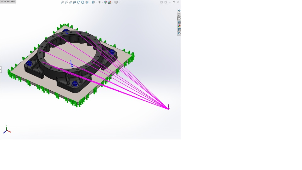

I have to perform a finite element analysis of an assembly. This is a static analysis.
I have to study how a componet af a hydraulic crane subject to a remote force applied to its upper surface perform. This cast iron support is connected to an iron plate.
I modeled the four upper washers, not the lower ones.
The washers have a non-penetration contact with the support.
The support has 4 non-penetration contacts with the iron plate.

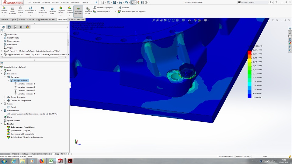

I individually defined 4 bolted joint restraints (standard or counterbore with nut) so I can find them listed beneath the connectors folder in the simulation manager tree.
I adopted the direct sparse solver for this study.
After the simulation, looking at the deformed assemby with 100x scale factor adopted, I can notice that the washers don't follow the holes in the support. Why?
Should I put some other constraint in the simulation in order to have a more realistic behaviour of the washers? I don't even know if I have obtained  valid stress values after this problem.
