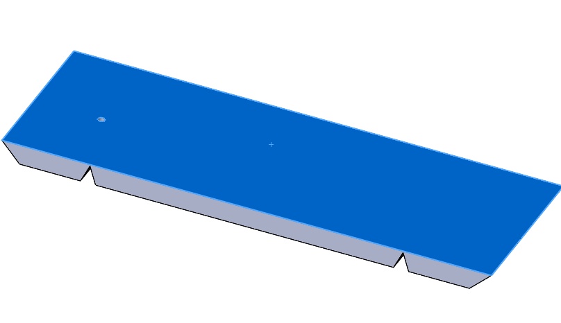

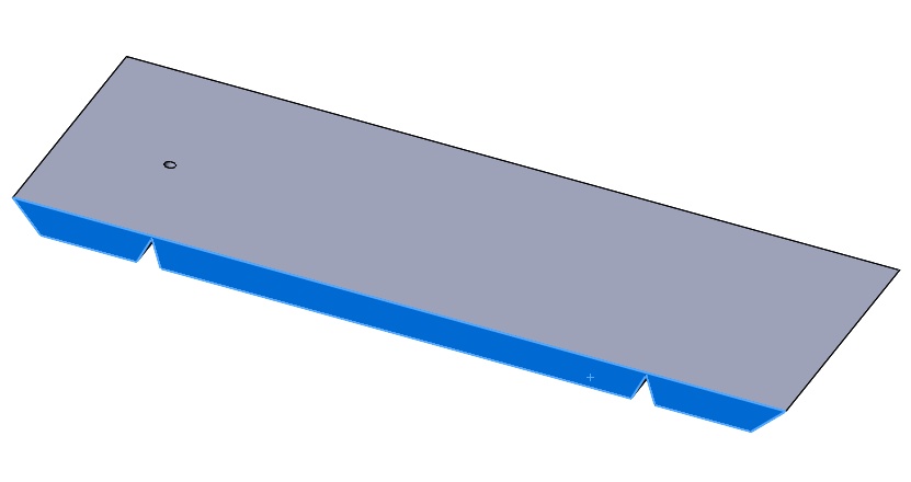

I need to find the perimeter length of parts. I also need to count how many internal features on a selected face - regardless of size.
The parts are made from sheet stock and shouldn't have thickness issues.
These come in as STEP files and won't have much intelligence to them.
I will select the face to use for the perimeter as well as faces for counting features. I don't need the feature perimeter, size, or type.
Examples:
The perimeter of this face is 25.743. The number of features is 1.
The perimeter of this face is 19.725. The number of features is 0.
