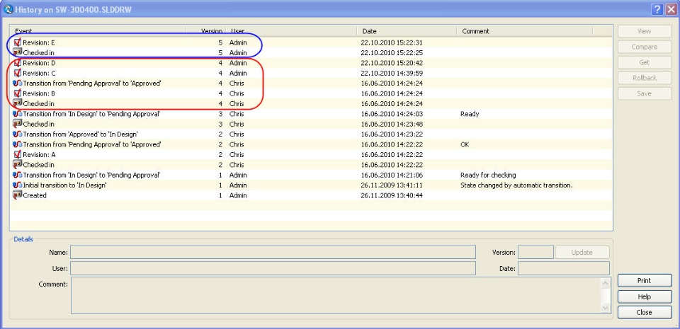

We appear to have some drawings in which the custom revision property doesn't match the EPDM "System" revision (I think something went wrong during the original import).  The drawings have the custom revision variable mapped to the title block, so the drawing may be at rev 'B', but the history shows the latest released rev to be 'A'.  I am trying to conduct a search to find all these drawings.
