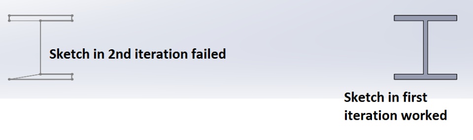

Here is the snapshot of sketch:
Actually, I confirmed that my sketch profile is perfect as expected but it gets disturbed after extrusion of sketch1 as shown in image below.
