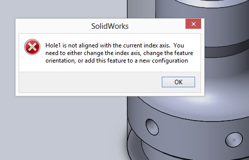

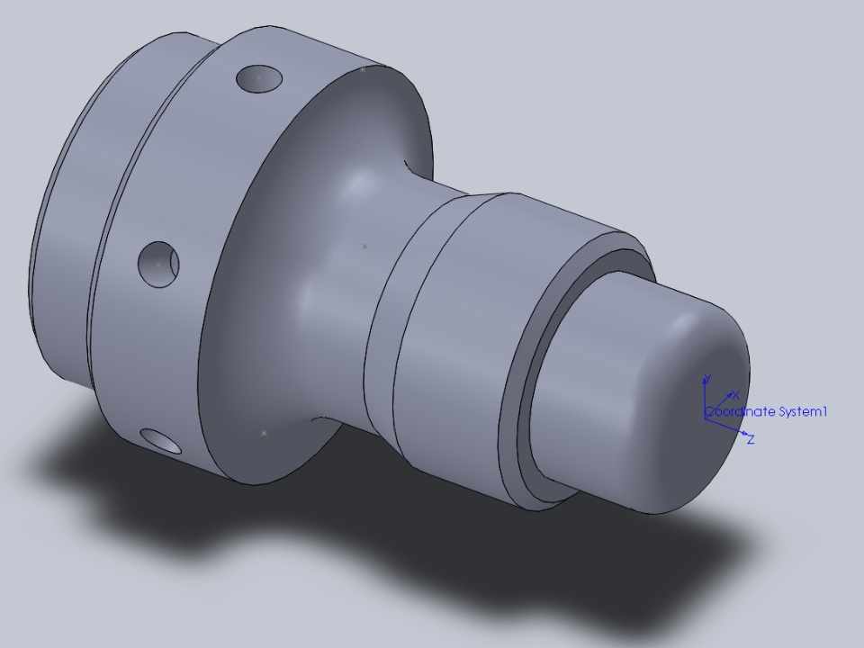

I have set up a UCS along the C/L of the part at one of the end faces. The part axis is the Z axis. I reference this same UCS in the stock and the setup for the periphery hole feature - but I constantly get the error that the axis for the pattern is not the same as the indexing axis - but quite simply, at least to me, it is.
Doubt that it's the source of the issue but: The features in the part is layed out as a 6 instance circular feature pattern referencing a Hole Wizard .25 hole located on a sketched point on the OD of the part. The circular pattern axis is the axis of the part.

The UCS I'm referencing in all FC operations:
The error message:

I've tried both using the Hole feature and feature recognition, both produce the error regardless that I'm using a UCS that matches the index axis. Any insight would be appreciated.
