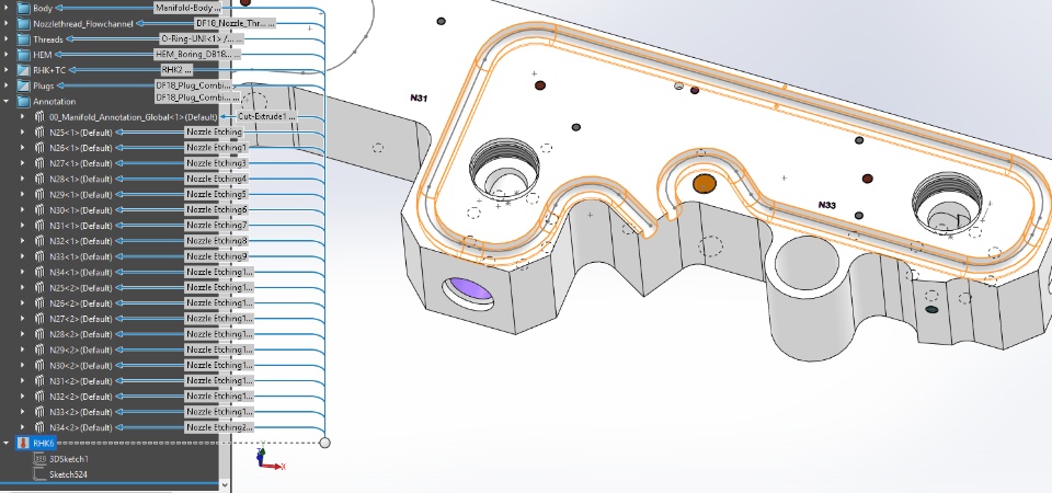

Now my problem is, that the references of the Feature contain EVERY feature in the design tree that modified the body before
I don't want these references! I was also able to reproduce this issue with the macrofeature from API Help:
2018 SOLIDWORKS API Help - Cut Body in Half using Macro Feature Example (VBA)
Is there any way I can remove those references? My Macrofeature is basically a modified version of a simple Swept Cut feature. The basic swept cut feature does not even have a input body reference: 2018 SOLIDWORKS API Help - ISweepFeatureData Interface Members
I already tried to remove the input body as reference in the macrofeaturedata object and obtain the current body during the rebuild method, but the references on the other features remain. I seems like, as soon as I modify an input body, every feature that has modified the body before is referenced.
