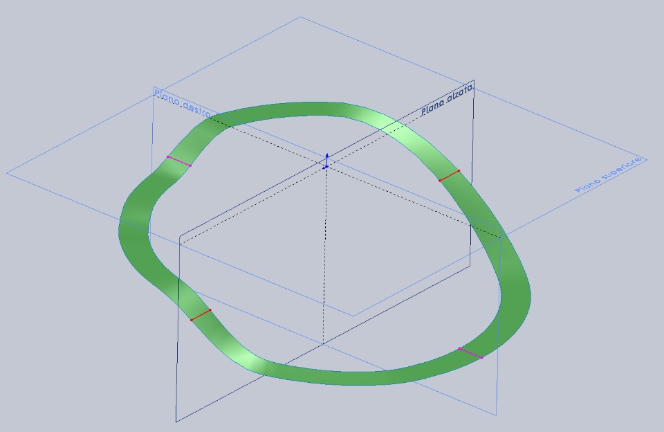

I would like to create a feature that generate a surface as in the attached image.
The single points for the two external curves, are calculated from the user parameters input in interface
But I can not find the sequence of function to call for the feature
