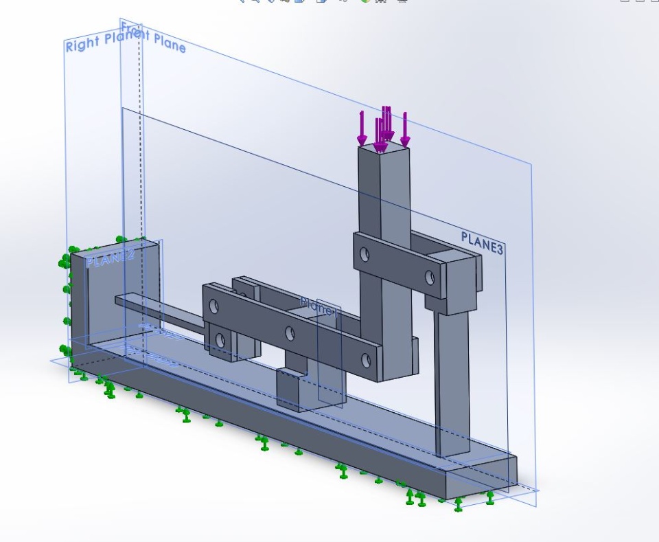

Hi,
I am trying to run a simulation on a force balance system, which has multiple pivot points on it in Solidworks. However, whenever I mesh and run the simulation in Solidworks, it turns it all into one solid component and neglects all the pivot points and turns them into weld points.
I've attached images so you can better understand what I mean.  So you can basically see the entire thing turned into one solid piece after I ran the test. How can I change this?
SolidworksSimulation

Are you using Pin connectors? That's what I would do. Ensure that your Pin options have the "With key" option unticked.

What are you trying to learn?
Is it a static problem?
Pin connectors and no penetration contacts should solve your problem but make sure you have a static problem and that your system has enough restraints in the pin axis direction.

Peter, I acutally didn't use pin connectors. I had used the Mate option then went into the simulation. I maybe thought that perhaps the mates were the issue, so I removed all the mates. However, even with those removed, Solidworks is still automatically turning the part into one solid piece.
J. Mather, I could do that, but I want to learn how to do it for myself because this is for a Senior Design project and I know I'll have to do it again in the future.
Jared, this is a force balance setup and I need to be able to measure the strain on the thin rods (the horizonal one on the left and the vertical one on the right). And yea, I have it setup as a static problem.
SF
SF 2014-02-14
mates do not transfer over to solidworks simulation
if all your parts are touching and the default bonded contact set is enabled, everything will be glued together
switch to no penetration and add pin contacts to make it act like a pinned assembly
make sure your problem is static (ie, no rigid body modes) or you're going to have trouble.

SF 2014-02-14
connections folder
change from bonded to no penetration

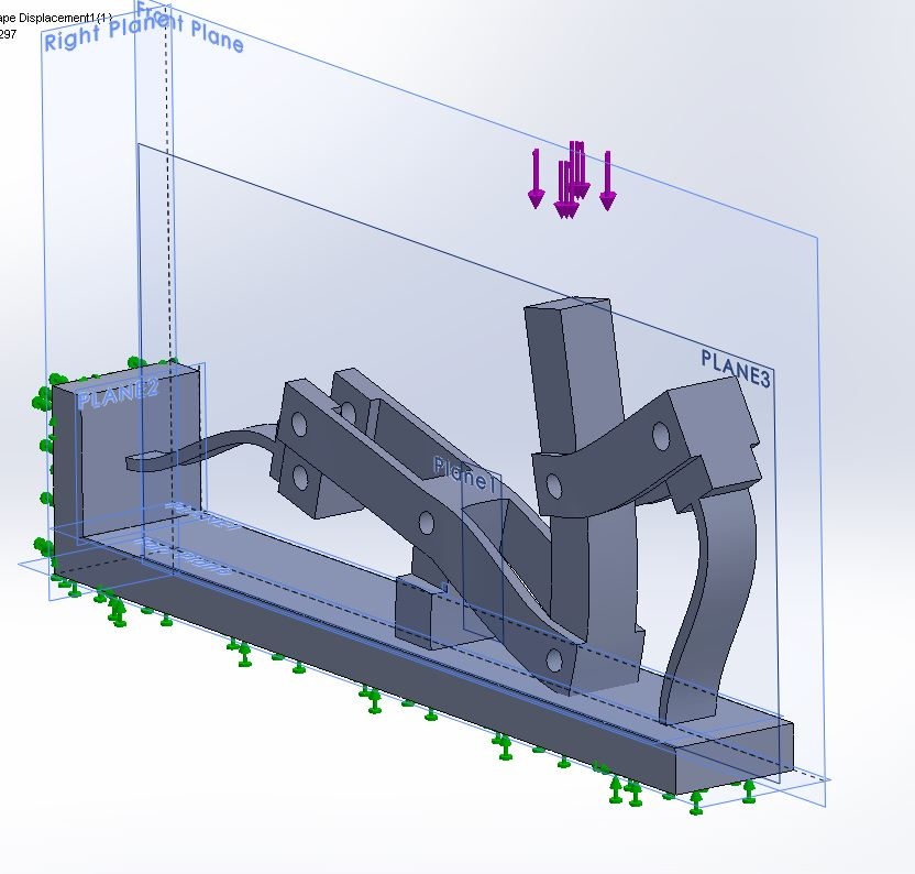

Thanks, I got it to run almost as expected now. However, I don't believe the result is even nearly accurate. I applied a force of only 0.01N (down) to the top square rod and the type of deformation I got is in the image below. The material type is Aluminum 6061-T6 (SS).

What maximum value is it giving you for deformation? Most likely just need to change plot settings, as solidworks is set to automatically exaggerate deformation to help you visualise what is going on.
"Edit definition" on your displacement plot and select "True Scale".
You can select that on all of your plots if you wish.

Ohok, the simulation looks much better and more realistic now.
Now my last question is.. How can I get a strain reading at a point on the model?
SF
SF 2014-02-14
Right click on the plot name and select "Probe", then you can click anywhere on the model and get a value.
