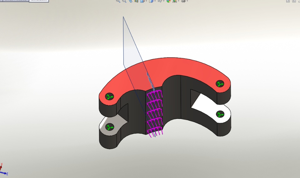

i'm having troubles tests parts in my system that are pinned at both ends with forces acting in the center. I've been trying to use the simulation package however I can't seem to get the correct fixtures. As per the attached screen shots, I have a arc-structure that has a perpendicular and tangential force acting at some point near the center. Does anyone know what kind of connectgions or fixtures I can use at either end so that they act like pinned connections? When not under load this link can rotate freely about either pin.

Cut it in half and apply symmetry
That will deal with the missing restraint
Then apply hinges at the holes.
That should solve. But it does assume the parts connected to it are stiff enough to not move and that the pins don't deform the hole.

Hey thanks for the reply.
Where should I cut the part? At the cross section where I'm interested ie max bending or literally in half? How do I apply symmetry?
SD
SD 2014-03-03
The symmetry cut is along a plane that the geometry is symmetric about (i.e. a plane that, if you mirrored your symmetric geometry about, you would get your full geometry). Regarding the symmetry constraints, you could either use  the symmetry constraint or you could use a planar constraint.
