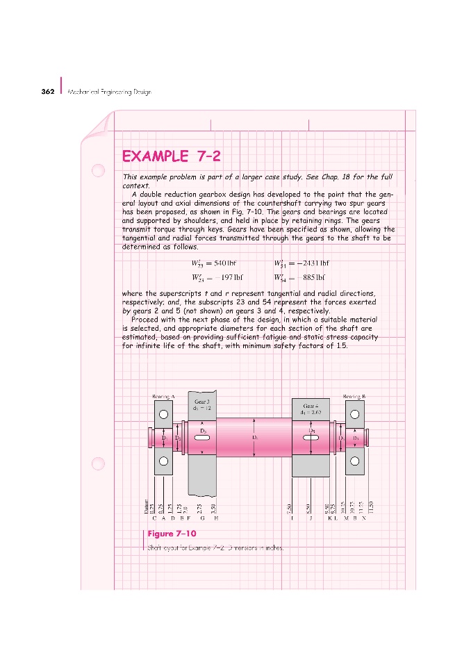

Hi guys. I´m trying to simulate a fatigue analysis on a shaft. I got one example from shigley´s book.
I made a drawing of the shaft and I defined some restrictions and loads, which I don´t know if they are correct.
So, I have some doubts I would like you to help me with.
-I made an analysis defining the fixtures with the bearing fixture option, and made another with the cylindrical surface fixture option restraining the radial movement on one and the radial an axial movement on the other letting the rotation free(I guees). The results were diferent, and neither of them matched with the results of the book. With results, I mean the reactions...So, which is the difference between defining the bearing fixture option and the cylindrical surface fixture? Besides, in the bearing fixture there is a Stabilize shaft rotation option whitch also changes the results if is activated. What is this option for? When this options wasn´t activated the program couldn´t make the analysis because of the big displacements.
For the fatigue analysis: Should I make 4 diferent simulations(2radial forces and 2 tangencial forces? o just 1 with all of them since they are all alternating?
Thank you very much. I leave you the files if you want to see them.

hi again. I read this in other post:
<p>Jared Conway escribió:</p><p></p><div class="jive-rendered-content"><p>bearing fixtures are with respect to the environment, bearing connectors are relative to the components. since you have both, your shaft is really just supported by the environment. suppress those then you have bearings that are relative between the shaft and the housing. your simulation will fail. if you turn on stabilization on one of them, your simulation will succeed but the results will look a bit wonky. that is because stabilization is a subset of the soft spring command that is really just for troubleshooting. the reason this succeeds is because there is a small inbalance in the forces that cause a rigid body motion that rotates the shaft relative to the frame which is a no no for static analysis. so what I did is I got rid of the stabilization in the bearing connector and replaced it with a spring at the bearing connection area. that bearing was given 100lb-in stiffness in the shear direction. run that and you've got a solution that looks pretty reasonable. now the question will be is that ok from a restraint perspective or not. If not, you'll have to play around with some conditions that hold things together.</p></div>
that helped me a lot to solve this example: (i got the correct answer with stabilization only on one bearing fixture)
But with this other example, the solution was only right without stabilization
with stabilization (no torque trought the right part of the shaft)
Can you explain me why is that?
thanks

i was thinking of this:
in the first model, the remote loads produce moments which have opposite directions, but because of there are small differences in the magnitude of the loads or the distance, i need to enable the stabilization to get the correct answer.
solidworks model:
But in the other example, there is only one load defined, and if i use the stabilization on one bearing fixture, then, the program will apply and opposite load of the remote load so there will not be torque in the right part of the shaft.
Jared, what do you think of my  hypothesis?
