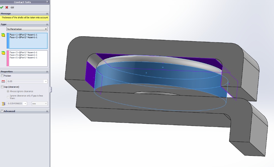

I often have assemblies with a roller running in a C-channel rail.  The roller can contact the front, side, or rear of the rail.  Usually I have a good idea which will or will not make contact, depending on the loading, but have found that they all possible directions need to be defined to get a solution.  As I watch the solver pick through all the possible combinations I suspect that I coould help it along byt being more explicit and putting in everything I already know for sure.
What is the best way to set up the contact pairs, for speed?  [see example screencaps]
I could put all the surfaces in one set, the cylindrical and flat face of the roller and the three flat faces of the rail.

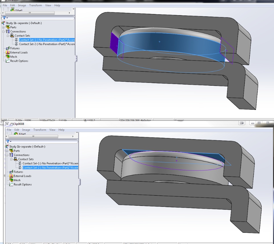

The side-thrust and rolling motions could be separated, so the flat face of the roller is in one set and the cylinder in the other.
All could be set up separately.

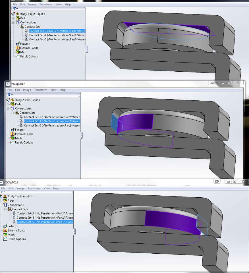

But how about the cylinder?  Does the solver have to do anything special to deal with this shape that comes around on itself?
In some cases I have split the cylindrical face and then had three separate contact sets with nothing in common.
Another question not illustrated here - Since the rails are usually very long compared to the roller size, and I know generally where the roller might contact, does it help any to split them up so that the entire length is not considered?

My view would be the last case  above but with the split lines moved (and added to both surface sides) to the smallest region of contact you feel confortable in specifiying (ie you know where contact will occur and just specify those regions.For solve speed that would be fastest. The other thing is that for the round to flat surface to surface contact is likely better for results and node to surface for the flat to flat for speed.

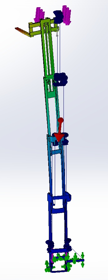

Here's a snapshot (displacement plot) of the most complicated one I've managed so far - a four stage fork lift mast, with carriage and forks.  There are four sets of rollers, four per set.  In addition there are two pairs of chain and a pair of hydraulic cylinders each of which bridge across three of the four sections.  Another pair of chains lifts the carriage in the top section and another par of cylinders controls the fore/aft tilt of the whole thing.  At full exetension and rated load, the top twists and bends to the side multiple inches, which is what we do see in real life.
I've got this one running in just over an hour with a little under 300,000 second order elements, 1.5 million DOF.  But other models set up similarly take a lot longer to run, and I'm trying to narrow down why.

What is the object of doing the analysis like this? By this I mean modeling these contacts this way in the context of the system level analysis shown. What are you after and why do think you need to approach it this way. You can certainly get the right load path in the mast without resorting to this level of complication at the system level. It depends what you are after though. Also the problem looks like it might be better handled in the NL solver given the large displacements of the mast. Why analyze the forks in this analysis when you could remove them and use the remote load as an example.

The ultimate goal is stress values and total deflection of the assembly.  Down the line I'd like to get some idea of the total stored energy, which impacts the stability of a maneuvering fork truck.  I also run the physical testing lab, and it's an all day job just to set up one loading, it's difficult to get just total deflection let alone twist, and right now we don't even have organic capability to tilt sideways (which is part of a standard stability test).
We've tried non-contact analysis a number of ways, such as modeling each piece one at a time and tranferring the resultant loads to the next piece manually, or tying the weldments together with skinny solid bars.  All we'd get out of that is stress results with a lot of uncertainty.  So one I day I started trying to be more and more literal about it.  It took a long time to get a stable run, but I seem to have that licked.  The last step was adding articulated pairs of chains over simulated sheaves (a rigid pivot on a bearing connector).
The problem is not non-linear at all.  Stresses in each weldment are all well below yield.  The total displacement in a bad case is only around 1.5% of the extended length, and much of that comes from take-up of slack, even in my ideally shimmed unit with .25 mm initial gaps.  I just have to make sure I force it to 'solve with small displacements'.
I put the forks in because it's one more step toward being totally literal, it looks better in the report, and it's actually easier than working out the moments for each case to apply loads to the carriage.

in the long run the way to reduce solve time is not based on how you create them it is how many you create.
i haven't read the full back and forth between you and bill but i think he's saying the same thing that i'm going to say:
1. if you can simplify to bonded, do it
2. if you can simplfy your assembly, do it
3. use split lines if contact isn;t going to happen on the whole face to reduce the contact that is calculated
when you have your model down to a reasonable size, the solve time is what the solve time is.
