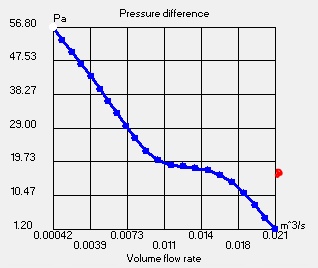

Below is the fan curve I've inserted into SW where I've marked the working point in the simulation with a red dot.
My entered fan curve at zero pressure is 0.0211389 m3/s.
My working point in the simulation ends up at ~0.0211399 m3/s with a pressure difference of ~17 Pa (measured as the average value of the fans surfaces).

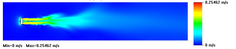

Here is an example of the flow field with a mesh of ~1.3mio autorefined cells:
Im using an internal axial fan with the dimensions and properties provided by the manufacturer in an external flow simulation.
