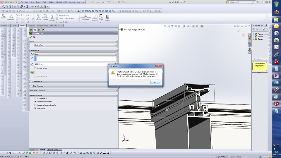

I am making an extruded cut in an assembly.

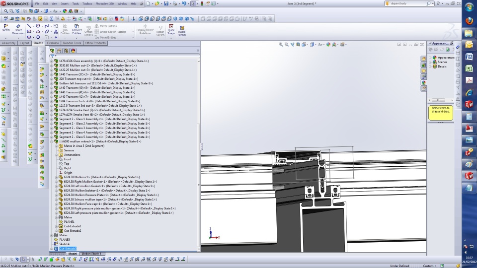

The rectangular cut boundary sketch surrounds the parts that need to be chopped. - See picture below
However, the cut does not cut through one of the components as the picture below shows.

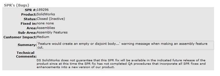

Also i have found this is spr  189296.
Would anyone know a way around this?
