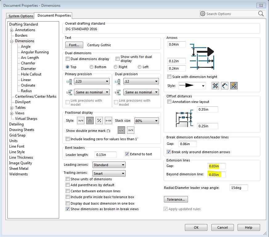

However the extension past the dim line was set up to an earlier format @ .06 in and we are trying to adjust it to .03 in
I have set the new standard in the sheet format in:
Document Properties > Dimensions > Extension Lines > Gap and Beyond Dimension Line
this change is not reflected in the saved dim styles when they are placed in the drawing:
until I go to the Tolerance/Precision area and click on either input box then tab out of it:
This is fine and normally I would just update and overwrite the saved dim style, however even after updating and saving the dim style I still have to go through the whole rigmarole again to get the lines to conform to the new style, hitting Ctrl + Q doesn't update the appearance either. The only way that works to get the new format in is to "Edit" the tolerance/precision value (as mentioned above simply clicking the value input box and then "tab"-ing out of it works).
