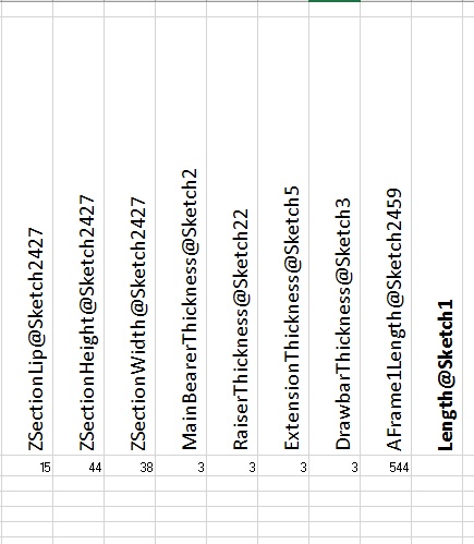

Hi Team,
I am having trouble being able to get my driven dimension into my external design table file.
Steps taken:
-added new driven dimension to part file eg Length@Sketch1
-added driven dimension to design table named Length@Sketch1
-updated design table (no dimension was added beneath the )
-rebuilt the part file
I have read elsewhere that people have managed to extract the driven dimensions from a file into excel via a design table. Would anyone be able to guide me through this.
