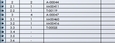

We noticed when creating the BOM some of the assemblies don`t show sub-parts see below: We have 2 identical instances of part A-00047. One shows sub-parts the other one doesn`t. That basically screws over our BOM and part counts.
When we switch configuration to Default (All components together). I can see all of them: (see item 3 -  QTY - 4..
