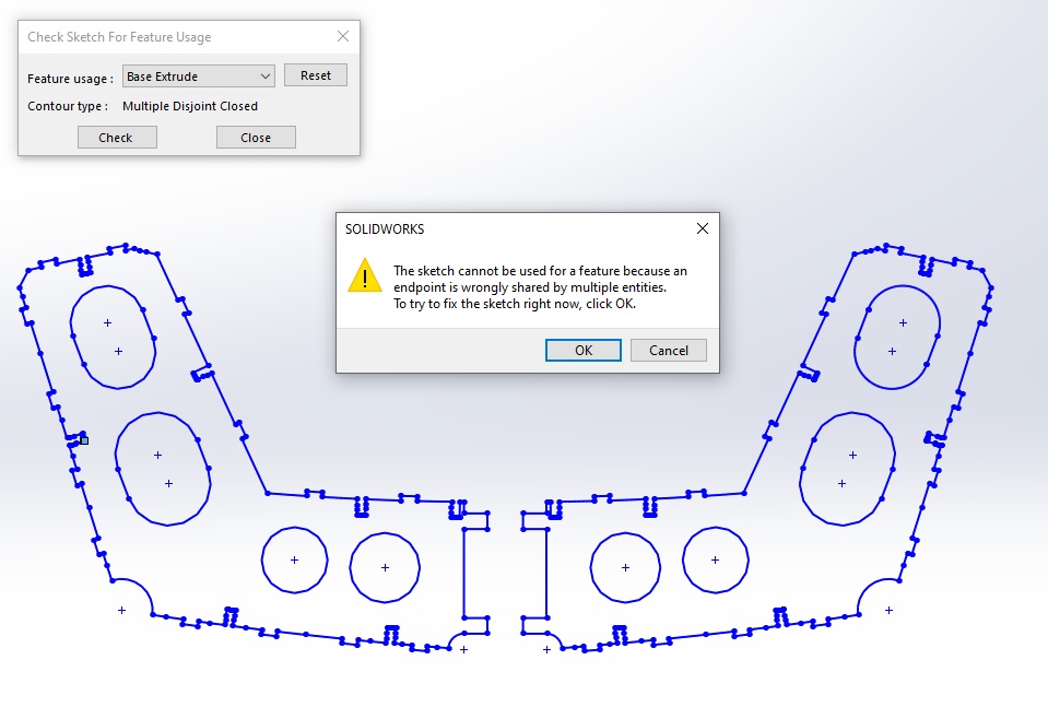

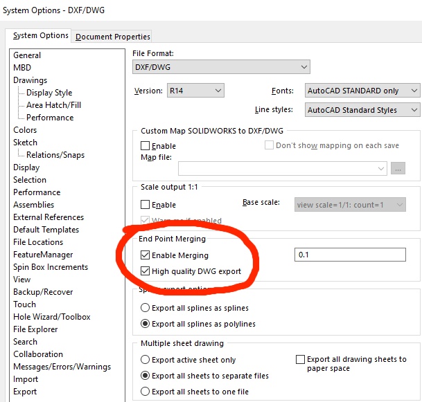

I have a project in which I need to export a SOLIDWORKS part drawing as a DXF for nesting and CNC cutting. I noticed that many times, exported DXF has gaps and overlapping but not merged line endpoints, which often results in failures when importing these DXF files in other software. I managed to close the gaps by using Enable Merging in DXF export options:
But I still have the issue of wrongly shared endpoints. I made a test. I exported one of my drawings as a DXF, then re-imported it back into SOLIDWORKS as a 2D sketch, and used Check Sketch feature to see if it could be used with a Boss Extrude or any other function. And I get this:
And then I'm directed to these endpoints, which indeed have two line endpoints overlapping, but not merging. I don't see an option to automatically fix this when exporting DXF, and there are far too many files to make these fixes manually.
I am attaching one of the problematic models along with it's drawing (SW 2019). To replicate the problem:
1. Open the drawing;
2. Export it to a DXF file;
3. Import it back to SOLIDWORKS as a 2D sketch with point merging disabled (because the other software that I'm sending these DXF's to won't do that);
4. Try to perform Check Sketch, and you'll see the issue.
So, how can I export a clean, correct DXF from my drawing?
