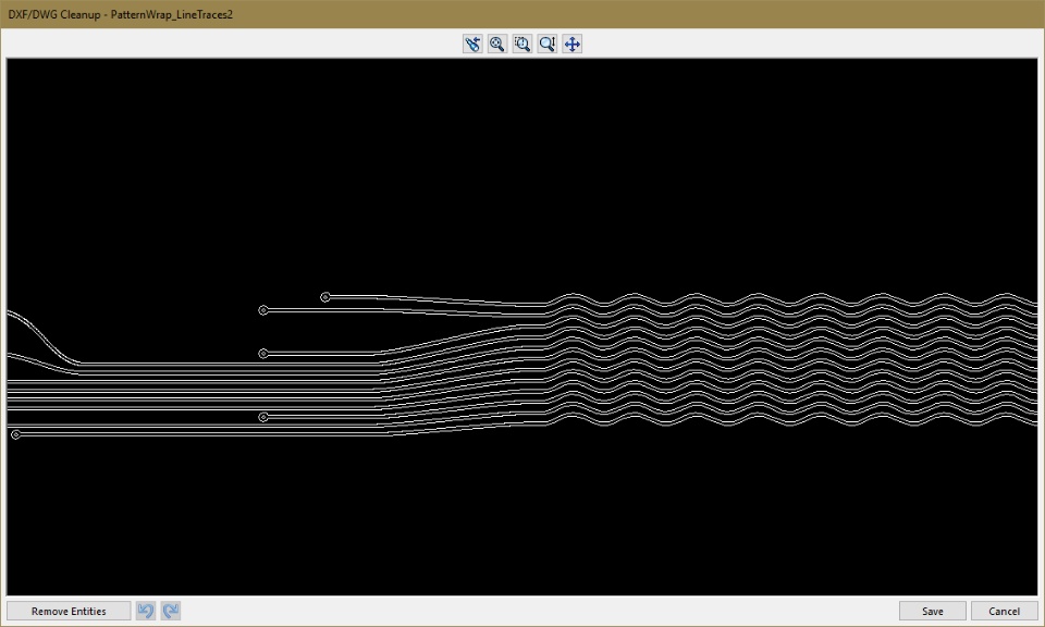

Attempt from model:
i right click on the extruded surface i want to export, select "export DXF/DWG" pick a file name, add additional surface closed loops (note that choosing single or multiple surfaces doesn't change outcome) on the same plane from the same extruded features then click the checkmark to export. At this point i get a pop-up labelled "DXF/DWG cleanup". In this window all my lines look correct and all the curves appear to be there. However after i click "save" the resulting DXF is nothing like what is shown in the cleanup view and all my most of my curves are gone. I don't understand why my output isn't the same as my cleanup view.
Cleanup view
Final DXF with no curves
I've tried maxing out resolution and detail in every image quality setting i could find, and every combination of DXF export options from the model and from a drawing view of the same feature and nothing will give me smooth or correct curves even though they appear ok inside of solidworks models and drawings.
