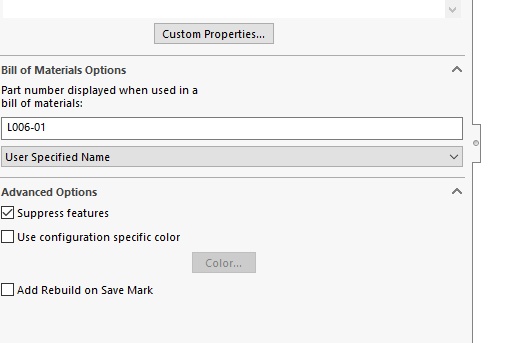

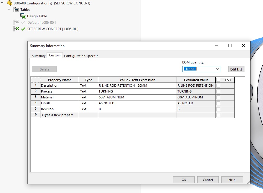

I was wondering if I could get some insight on how to modify a Deepak Gupta macro I found which exports the current configuration into a step file. I would just like it to be able to produce a filename with the user specified name for the Part Number used in BOMs and the current Revision.
So with the above example it would be L006-01 RevB.STEP
