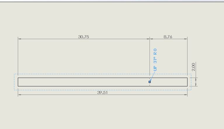

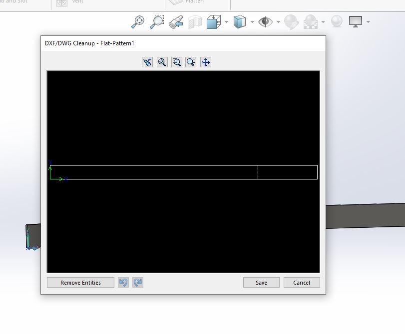

what im trying to accomplish is to export a part .DXF that we can send to the lasers, but link it, or base it off of the orientation of the flat view on the drawing.
For Ex:
I would like to get this Product, Flat sheet metal pattern with bend lines.
But based on the Orientation of the Flat View in the Drawing
I realize this IS the same orientation because I did it manually, what Im trying to accomplish is to add a step in my macro that will export the part .DXF version when I run the Macro, along with all my drawing Versions, but export it whatever orientation I have the flat pattern on the drawing, so I don't have to go back in to the part and save the .DXF to match on every part we do, is this possible?
