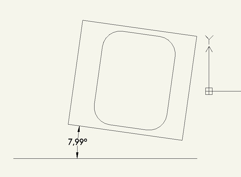

Due to nature of model positioning in 3D space the sheet metal is exported to DWG file under some xxx angle. Probably because flattened sheet metal is not on a plane or something.
So is it possible to export this contour to be aligned on bounding box?
I know I could probably align it with draftsight api if I exported bounding box too... but I would have problems to determine what contour is bounding box and what not.
So is it possible to do this within solidworks dwg export?
Or is it possible to put bounding box contour into some different layer or colour it differently?
