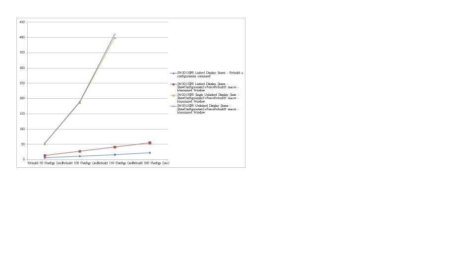

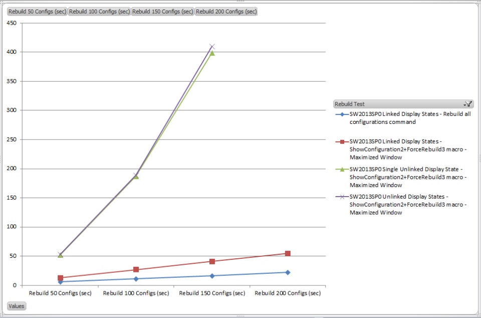

What I have found is that type 1 parts above have the same linear rebuild performance as parts prior to SW2010. However what I have also found is that type 2 and 3 parts now have exponential rebuild times. I have included a chart showing this behaviour in SW2013 (I actually tested every SW version from 2007 to 2013 – see the “SolidWorks Rebuild Performance.xlsx” spreadsheet I’ve attached to this post.
