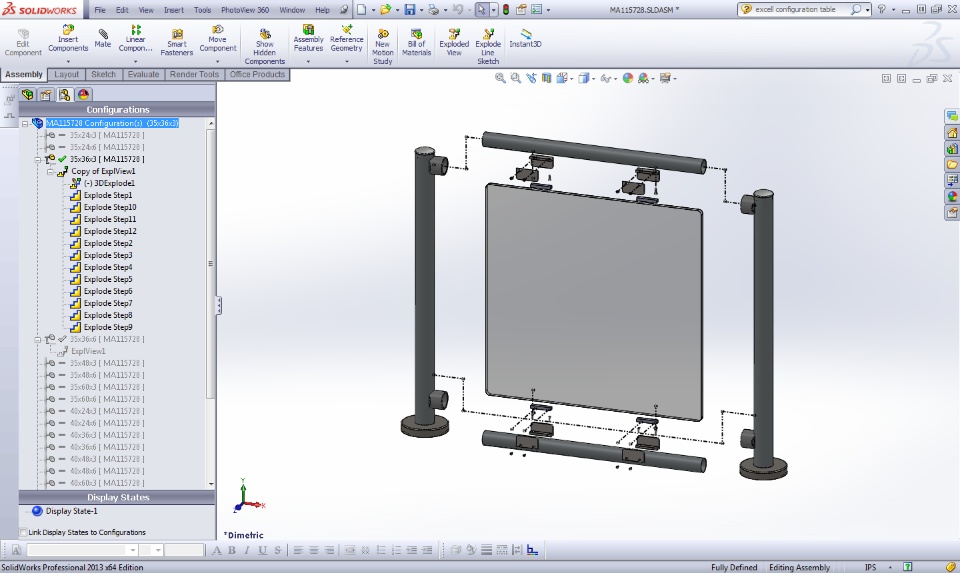

Pic1- is the configuration where i created the exploded view.

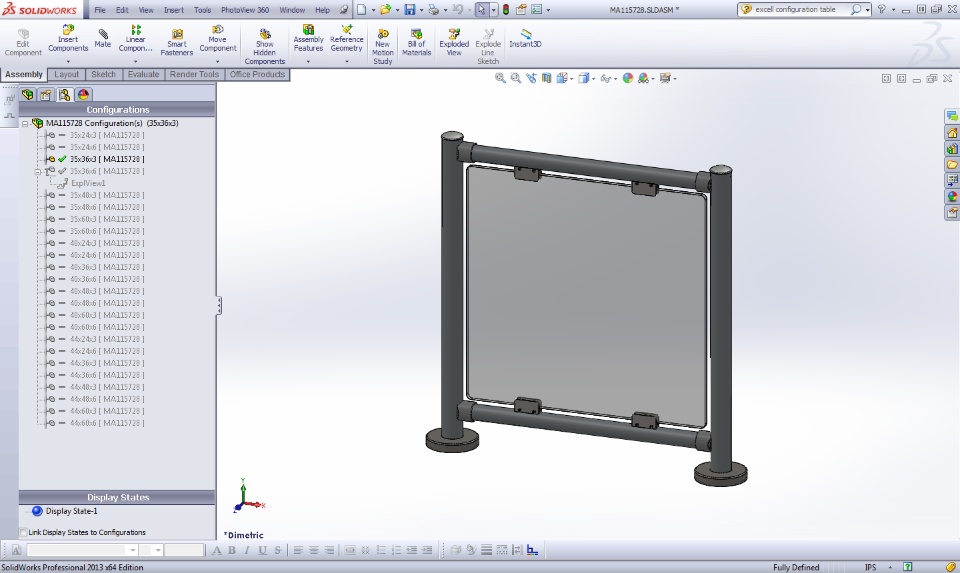

Pic2- is the configuration i want to copy the exploded view to...as well as the other configurations.

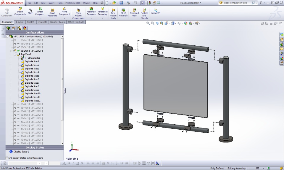

Pic3- is the original exploded view.

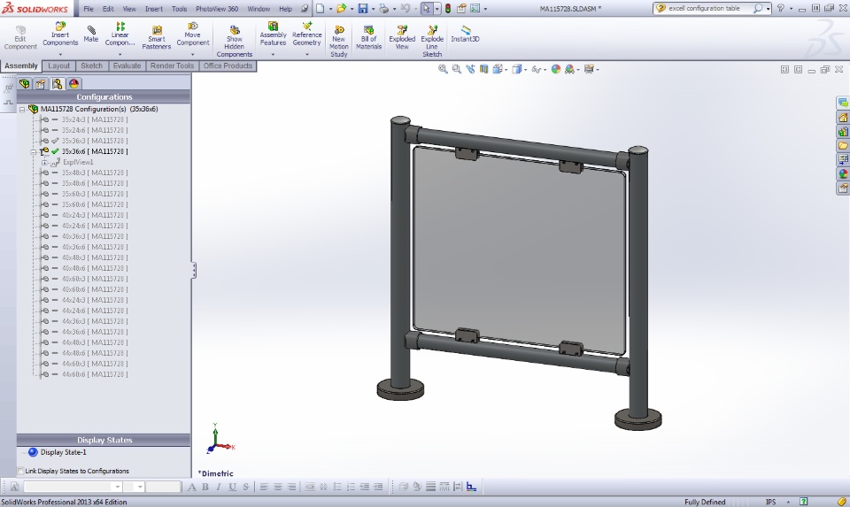

Pic4- is the copied exploded view.
Reference the bottom rail and the height of it in relation to the floor as well as the glass panel, as its cut height changes between each configuration.
Reference Pic4, copied exploded view, the lower rail and its exploded line sketches as they do not follow the parts' new locations.
