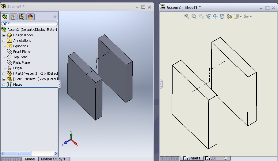

I have exploded and added explode lines to an assembly. However, I cannot get the drawing to display the explode lines. I can turn the explode lines on and off in the assembly by hiding or showing the 3D sketch called ExplView1in the Configurations tab, but no such tab or sketch is available from the drawing space. Sketches in the drawing are specified to be visible. Help does not talk about making these lines visible in drawings.
What am I missing? I hope it is something simple and that I'll feel so embarrassed that I'll remember this for the future.
SW 2010 SP4.0.
