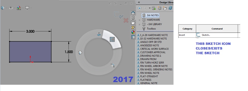

So I have a problem as I re-establish my mouse gestures within the new 2018 drag-and-drop setup.

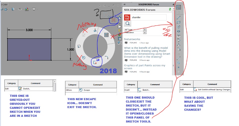

I cannot find the icon that lets me exit a sketch AND SAVE the changes.
The exit sketch w/o saving is cool, but not what I need.
It used to be that the "Insert Sketch" icon would exit the sketch, now it just opens a panel of sketch tools...
The other obvious icons, like "Escape" don't work either.
How can I exit a sketch and save my changes without moving up to the far top corner?
