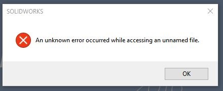

Running SW 2016 x64 SP5.0
I am trying to use this fantastic macro from Steve Takata to export all the embedded PDFs from our Workgroup PDM to a local folder.
The trouble i am having is that it gets to a certain point and pings up this error (typically at the most crucial point):
I have tried removing files from around the area that it stops with no success.
I'm therefore wondering if someone could help me exclude this folder, at current the macro excludes root folders but to my knowledge doesn't exclude sub folders.
This sounds like a simple task as most of the lines are there, but I have little knowledge with API.
Assuming its this line:
Function CreateFolderCheckForChild(proj As PDMWProject, previousPath As String)
but cant figure out how to include the excludeList filter.

Any help would be massively appreciated.
