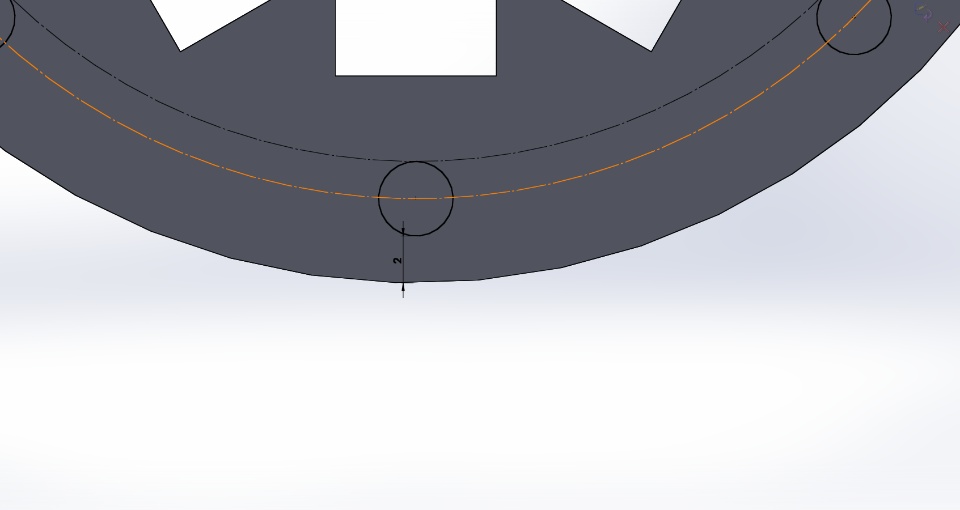

I'm using a design table to change values quickly between configurations, but when I go to change the outer diameter of the part, the holes flip around to the outside of the sketch, therefore breaking it.
Here's what I have currently. This is the wrong configuration.
Here's what I want to have. I can only get this by deleting the dimension, moving the holes and redimensioning it, which throws off my design table.
How can I get Solidworks to resolve my design table correctly (keep the holes INSIDE the part) every time?
