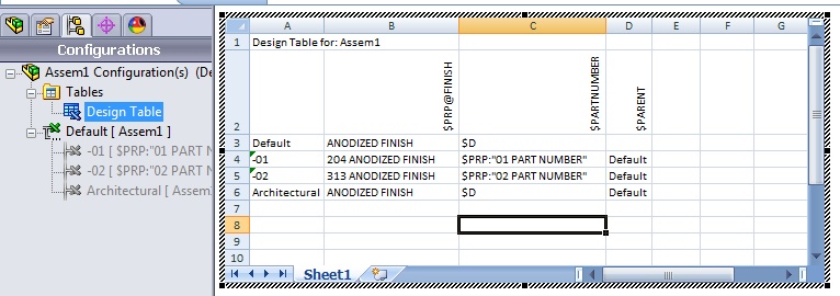

We have some properties that we would like to control individually between each configuration.  Often, the differences between the properties are pretty minor.  Here is a screen shot from an assembly template that I'm working on right now:
In the B column, I'm controlling a property called "FINISH".  By default, this column will indicate that the parts have an anodized finish, with the -01 and -02 specifying the 204 and 313 finishes specifically.  There will be some parts where we will want to specify a different type of finish (powder coated, for instance).  In those cases, the engineer would have to go through all four rows and change the text individually.  It would be a lot easier if I could use a concatenate command to drive this, so they only have to type over the B3 cell, and the "anodized finish" text would change in the other cells below.
However, when I tried to do this, the concatenate command wouldn't compute, and I'd be left with a long awkward text string that is useless to everyone:

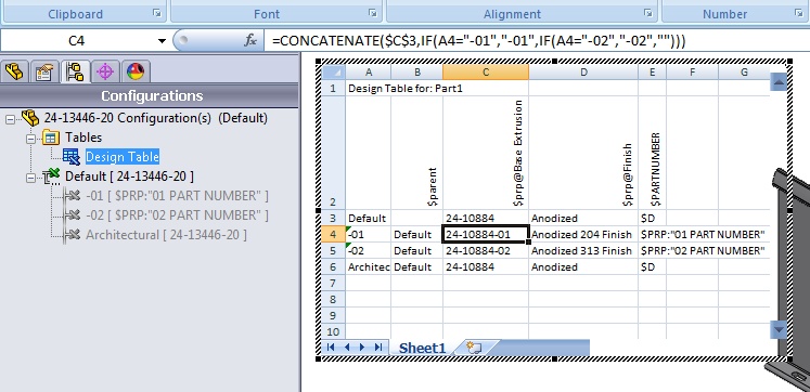

I'm not sure what I'm doing wrong here.  I did this for my .sldprt templates, and it works just fine (see the C and D columns):
Anybody have any ideas what's up here?
