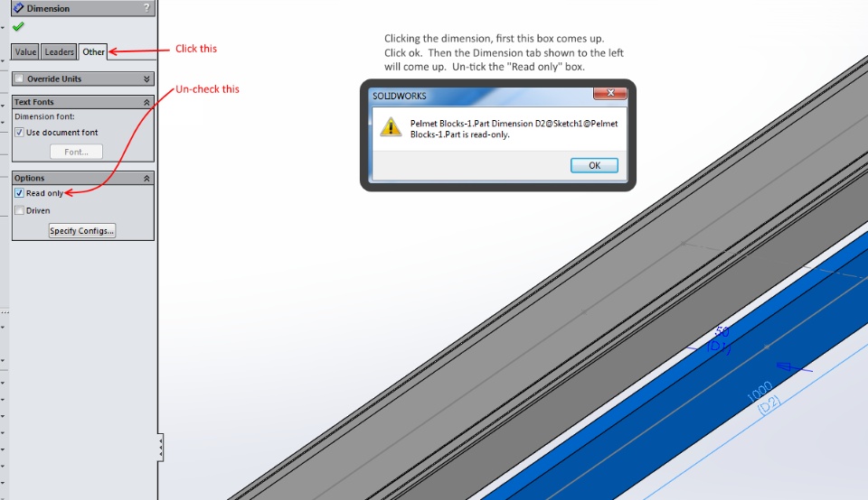

I'm baaaack.  Ha.  I have a couple of assemblies that I have created with equations in the parts dimensions relating to other parts.  I'd like to be able to edit these dimension values and do away with the equations, but they are not letting me edit them.  It appears I can edit them and put in hard values like I want in the parts, but if I go back into the assembly they revert back to their equations!!!  I have tried this over and over a few times and not getting anywhere.  The dimensions I'm trying to change are in "master sketches" in each part.  A few features in the part are then driven by the values of the dimensions in the master sketch.  I don't want to do away with the equations within the part, just the ones relating to another part in the assembly.  Any tricks to this?  Any thoughts would be greatly appreciated!  --Barry
