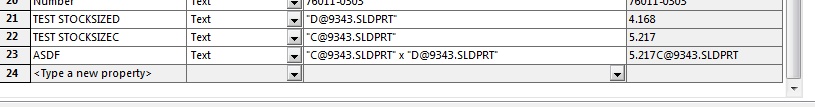

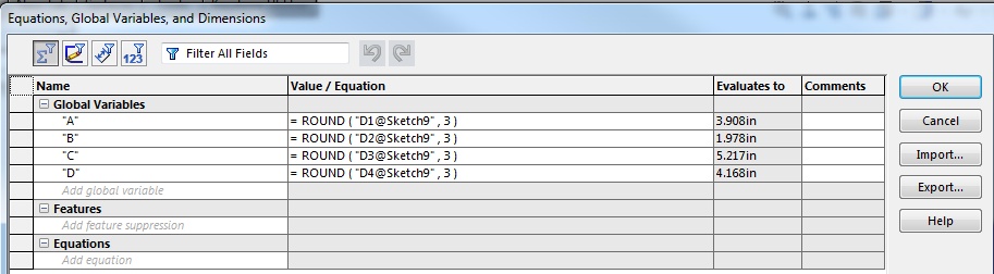

I have equations that are linked to dimensions to round them and i am trying to link them to a custom property in the part
custom property
the ASDF line should read "5.217 x 4.168"
but it doesn't.
does anyone know why
