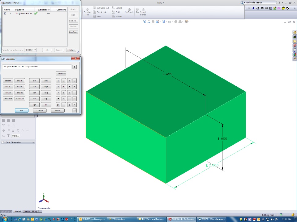

equations are disabled
I can not get equations to work on my machine (SW 2010 SP 4 WIN 7 x 64)
- I have uninstalled and reinstalled 3 times
- tested VBA with the Hello box (found in a different thread) and it is working
- searched for swvba.tba and found only one
I am at a loss, when ever I input an equation it can't solve it.  If I insert a toolbox bolt it comes in very wrong because there are equations in the sketch.
Has anyone else seen this?
Thanks
Lorne
