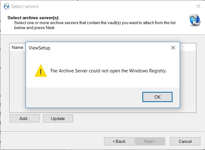

I am having an issue with running view setup on the new domain as it is unable to write to the registry with those users (see first attachment), as it states 'the archive server could not open the windows registry'.  I have confirmed I can go through the registry and make edits to the registry under local machine and user.

I am able to successfully install PDM no matter if I'm logged in as a user on the computer that is from original.local or new.local.  However, the only way I can get through the 'view setup' is I set a original.local user as a local administrator on the new.local computer.  While it cannot automatically see the server, I can add it manually and everything works correctly if I'm logged into a user from 'original.local'.  However, if I log into a local administrator account on the computer with the new.local domain user, no dice, whether I use the server name or its FQDN or IP address.

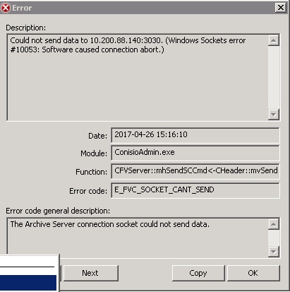

Once I run the view setup through an original.local domain account on a computer belonging to the new.local domain, I can log into EPDM without issue with a user from the new.local domain (no matter which account I use from the mentioned domains).  Basically, my only real issue is trying to run view setup.  I went into the logs, please see attachment, but it has not lead me to figuring out what the issue is exactly.  I have not been able to figure out a solution or what I may be missing on the archive server possibly, if not something else.  Any help would be appreciated.
