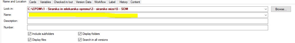

If you write text in search box it will search all words with OR option instead of AND.
Basically it's really difficult to search a file name that has to contain multiple words.
I know you can use quotes, but then it would have to be exact word.

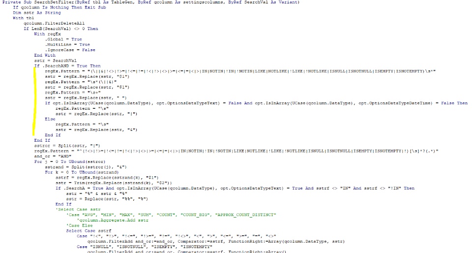

Basically I can share this how it could be done. It's from my excel program.
So then you could write 1 line search with AND and OR conditions.
