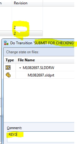

Hi,
I've set up the automated revision table within epdm and linked it to the workflow, everything is working fine apart from the desciption field.
At rev 1 all is OK but if the drawing is uppissued the comment added when submitted for checking enters into the new rev description but also all previsou revisions.
Part @ Rev 2 submitted for Rev 3 check:
Rev table once approved @ Rev 3
Ive looked through the variables and all seems in order.
Any ideas?
