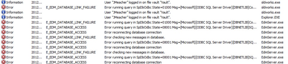

The error in the client and archive server log shows a database link failure.
