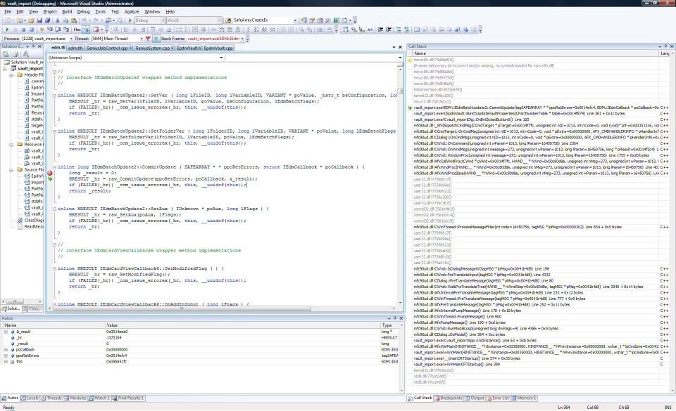

I am writing a standalone app for EPDM, and I am not able to make the CommitUpdate call work properly.  Does anyone see anything obiviously wrong with my commit update that i'm doing?  I have tried changing the size of the SAFEARRAY from -1,0, 1 and something really large like 10000000.

     Call the CommitUpdate method to actually write the variables to files and folders
     HRESULT hr = S_OK;
     ITypeLib *typelib = NULL;
     hr = ::LoadTypeLibEx(_T(
          "C:\\\\Users\\\\mlkress\\\\Documents\\\\Visual Studio 2008\\\\Projects\\\\EPDM2010\\\\Edm.tlb"), REGKIND_REGISTER, &typelib);
     const GUID IEDMLib = __uuidof(EDM::__EdmLib);
     hr = LoadRegTypeLib(IEDMLib, 5, 14, GetUserDefaultLCID(), &typelib );
     const GUID IEDMType = __uuidof(EDM::EdmBatchError2);
     ITypeInfo *typeInfo = NULL;
     typelib->GetTypeInfoOfGuid( IEDMType, &typeInfo );
     IRecordInfo *recordInfo = NULL;
     hr = GetRecordInfoFromTypeInfo( typeInfo, &recordInfo);
     SAFEARRAY *errors = NULL;
     SAFEARRAYBOUND dimensions[1];
     dimensions[0].cElements = -1;
     dimensions[0].lLbound = 0;
     EDM::IEdmCallbackPtr poCallback;
     errors = SafeArrayCreateEx(VT_RECORD, 1 , dimensions, recordInfo);
     long errorCount = poUtility->CommitUpdate(&errors, poCallback);
