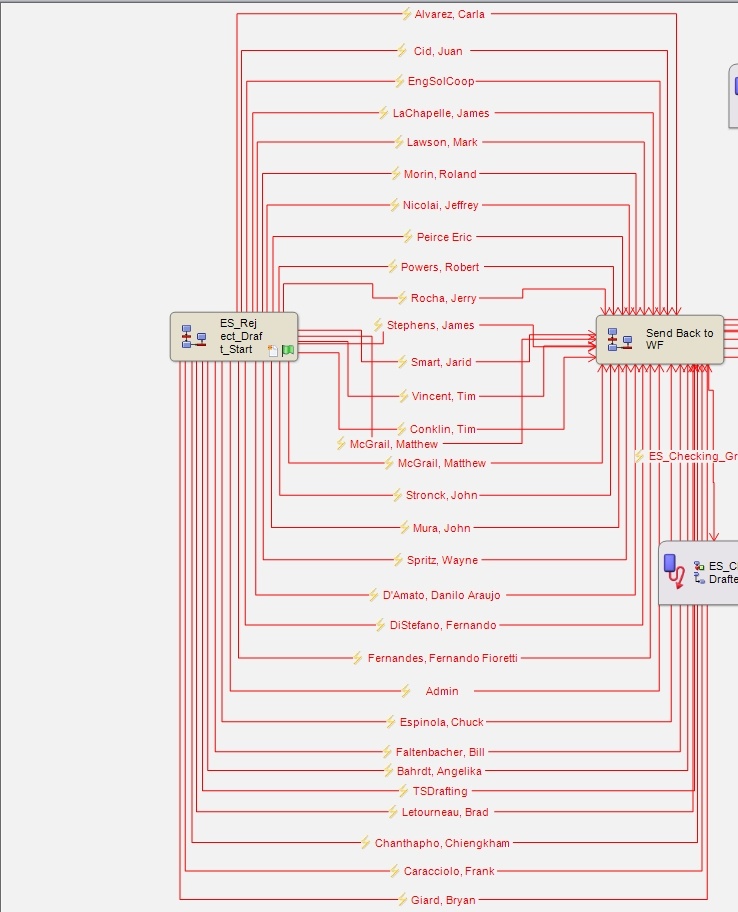

Enhancement request created for Transition, Action - Send mail to user, using a variable for username.
Please review the following enhancement request and add yourself to it if you find value in it.
ER 1-6001159658
EPDM Transition, Action - Send mail to user using a variable for username.
Transition, action, send mail in EPDM needs to offer a username variable in addition to Group and Username.
The additional functionality would eliminate two problems.
1. The administrative nightmare of creating filters for automatic notifications to individual users instead of a group.
2. Eliminate emails that users do not need to see. Too much email leads to ignored messages.
Thank for looking.
