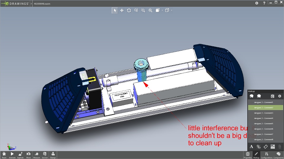

I like the new UI for edrawings-very much like the tablet version but the comments list can obscure comments in the lower right-hand corner.
It's not that big of an issue for new edrawings.  The comment list is up: you naturally work around it.  However, since comments are tied to a speciific camera position and orientation, if I try to pan the view, the comment disappears.
It's a minor gripe, since I can simply turn off the comment list in these cases, but I think the old way of having a seperate frame for comments, components and the like made for a cleanerworkflow-even if it wasn't as discoverable.
