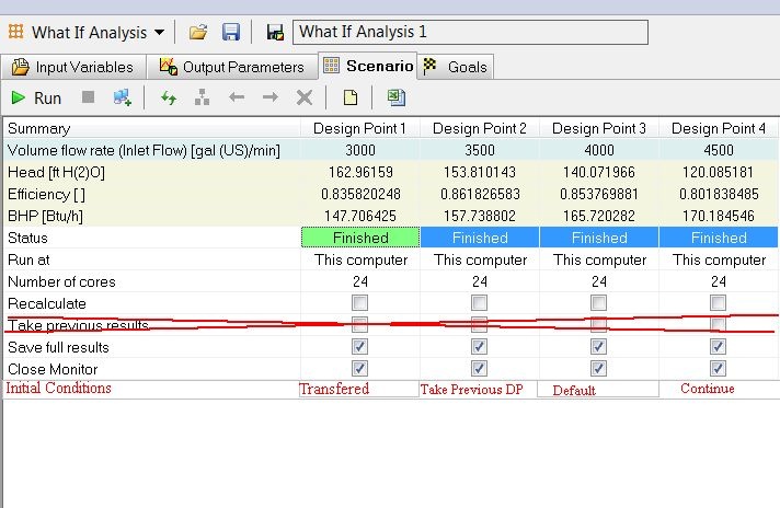

The Parametric Study "What If Scenario" has changed very little since SW2012 and it is till not enough functional to be of practical used. In my opinion the reason why is in lack of flexibility how to start/continue the runs of the Design Points. I suggest that instead of the switch "Take Previous Results" we have variable option pull-down menu with choices as shown in the attachment (all pull down menus associated with the Design Points should have a global pull-down menu as well which apply to all Points). With selected choices of the proposed 'Initial Conditions' Scenario, and checked boxes of "Recalculate" the runs of he Design Points should be executed according to the selected scenario of the "Initial Conditions". Similarly, the same Initial Conditions should apply at the time the Study is started for the firs time with thr difference that "Continue" will take the Initial Data as specified in the Parent Configuration of the Parametric Study instead taking the previous result of the corresponding Design Point (the later is case under "Recalculate").
