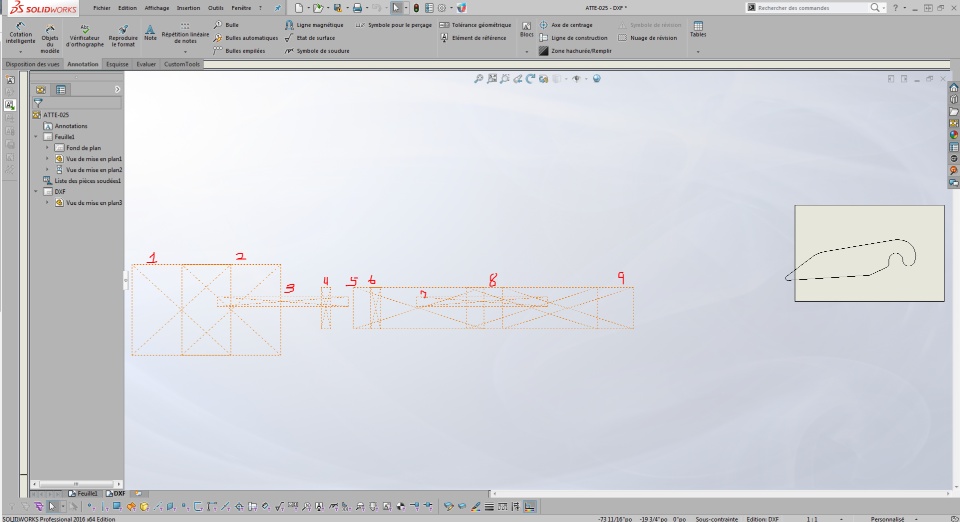

When I make a new drawing, there is almost always empty view shells floating around. I do not know where they come from because my templates are empty. Those view shells generally represent every view available in SolidWorks, including Annotation views. In order for them to ''show'', I have to use the ''View>Show/Hide>Show hidden views'' which, by the way, doesn't work correctly. It doesn't show the hidden views when I use it unless I change sheet or save. When that trick doesn't work, I end up clicking around in the drawing for about 15 minutes until I can locate them as a blind man would. When they hidden views do show up, like the screenshot below, there is no way to make them show a model, they will always remain a big red X.
Here is where it gets tricky. Those view shells are not shown in the feature tree. Not only that, they are not linked to a sheet, they are linked to the drawing itself. What I mean by that is that the views show up on every sheet until you erase it from one sheet. When the views are all erased from the sheet, they never show up again on any sheet whatsoever.
Those views seem to be linked to the drawing but I haven't found a way to get them to show a model...
I usually have between 8 and 14 empty shell views floating around, I was hoping I could find either what causes it or a solution to it or even both.
Here is a screenshot to show you what I mean, I have also uploaded a .sldprt along with a .slddrw for you guys to see it. There is 9 empty shells on that drawing
