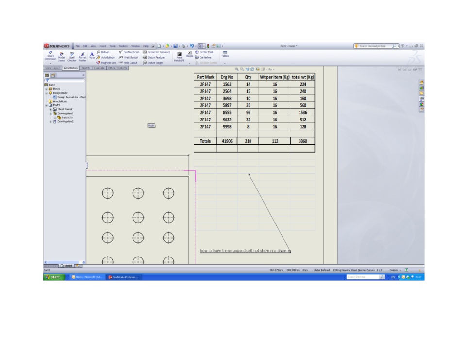

Hi,
Probably a really easy solution to this, but I cannot figure it out.
I have an linked Excel spread sheet in a drawing.
How do I hide the cells that are not used in the spread sheet showing up on my drawing.
I have tried moving the page area around in Excel so that one page is the list but still shows rows / columns below the table.
See attached word doc for screen shot.
Thanks
Mark (SolidWorks 2012)
