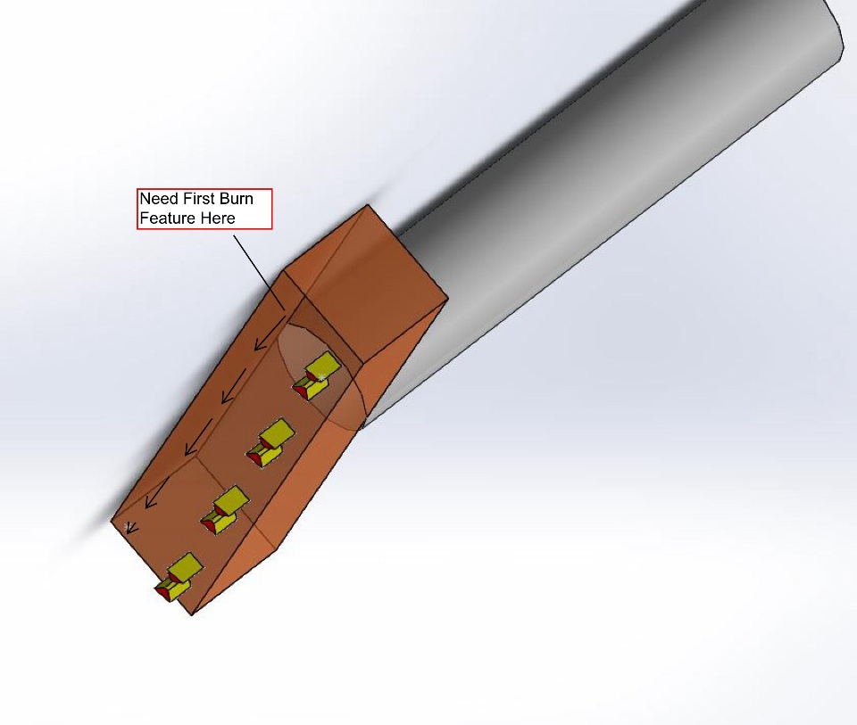

We recently started using Electrode Works add on. When creating an electrode we had a form that was not machinable so I created clearance and skipped feature to come back with second burn and finish. Normally in this instance we place the second op on the back edge of the same electrode and offset to burn second feature.
Is there a method to offset electrode and create second feature behind the first so that the first burn feature hangs off back of part and second feature is created?
