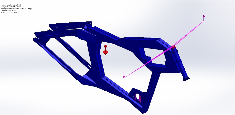

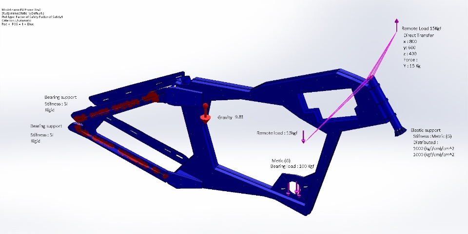

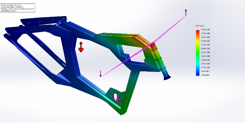

Hello,
I am trying to run a static analysis on electric bikes frame but I am not sure if all the loads and fixture that I applied are enough to get the correct result .
I do have the results but still not sure if this is correct.
I would appreciate an expert advise .
I look forward to hearing from you.
