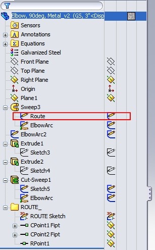

I made a simple assembly of elbows, pipes, tees, and unions, because im taking our new library of parts for a test drive.
I went to change the route diameter, and unfortunately the radius stayed the same while the rest of the parts changed from 2" to 4", so of course, the 4" elbows didnt like the smaller radius, and now ive got pretty red elbows and error messages instead of 4" elbows. Upon returning to the main assembly, the elbows just simple arent there anymore because a valid configuration wasn't available.
Why arent my radii updating to account for the new size of pipe?
