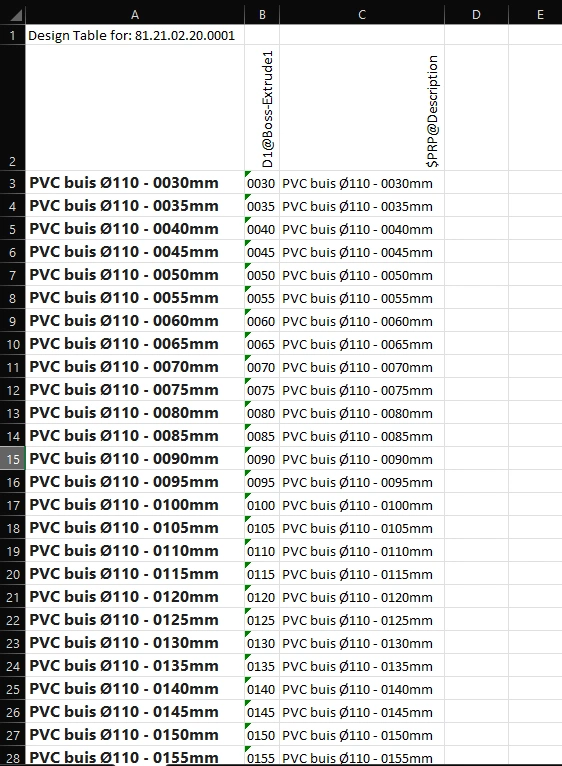

Currently, we work in SOLIDWORKS Professional (no Routing add-in) and manage straight pipes, such as PVC, by using configurations within a single part file. Each possible length (every 5mm step) is a configuration, controlled through a design table (see image).
Our typical workflow:
We drag the pipe into an assembly
Select the required length via configuration
Duplicate components as needed (Ctrl+drag) and set each to the correct configuration
If something changes, we just click and switch the configuration directly
We use mates to connect the PVC pipes to PVC fittings inside the assembly
We usually place these assemblies either as main assemblies or subassemblies, and we use the pipe configurations to optimize the fit within the overall structure
For production, each length appears clearly on dedicated workshop drawings. Purchasing always orders standard stock lengths; only production cuts them per drawing.
The actual lengths we need are determined by the assemblies in which the pipes are used, not predefined.
