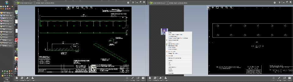

When eDrawings is maximised the main window is not centered on the frame. I get the window border on the edge of my screen, but the window contents are offset, and I can see (and select!) items behind it (i.e. within the border).

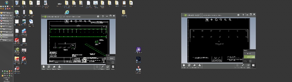

View of two windows open, restored and centred on each monitor:
Both winows maximised, but desktop visible and selectable due to offset.

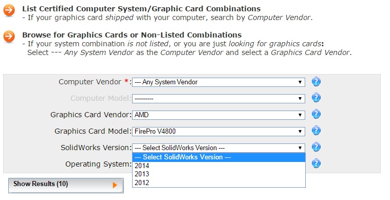

Is this a driver issue? Are 2015-compatible drivers not available for my GPU?
