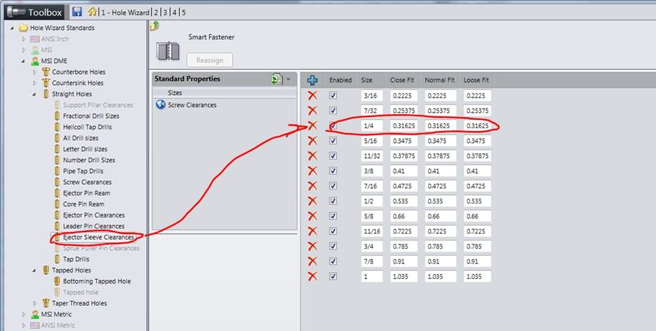

Okay...we are pulling our hair out.  When we go into system options, hole wizard/toolbox, configure, hole wizard...and edit/change a standard & save...it does not save/update/change.
We go to the standard we want to change...
We change it to the new size we want it to default to...and hit save...

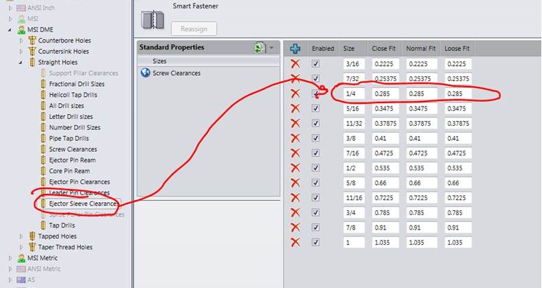

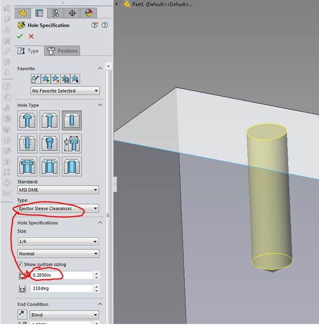

Yet when we put in that hole in Solidworks, it defaults to the old size...
And when we go into the hole wizard standards, it no longer reflects the size change that we had made and saved...
We have even deleted that line, saved, and when we go back into it, that line is back.  GRRRR!
